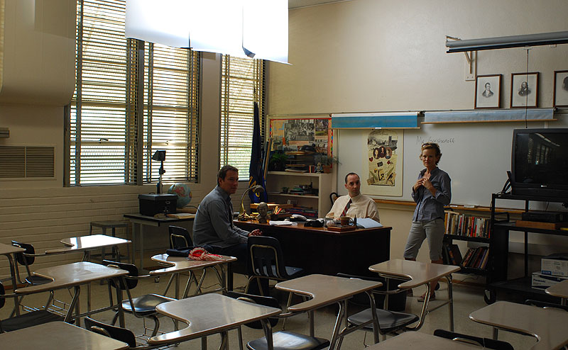

This is a classroom, lit by bouncing a Source-4 / Joker 800 HMI combo into a white card at the top of the windows:
