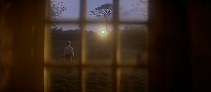

All these filters are light-scatterers -- mist particles in the glass cause light areas to spread, halate. They mainly vary in the degree of milkiness that cause, and the degree of softening, and some color cast issues (fog filters tend to cause a glow to be blue-ish compared to a ProMist). Fogs and Double-Fogs (which are just a Fog plus a Low Con, they are actually less foggy than Fogs, depending on the strength, but conversely are milkier) are older filter designs (1970's and earlier), ProMists date back to the 1980's. ProMists have a softening quality, not just the hazy foggy look.
The strength of the filter makes a big difference in effect when comparing them.
For a foggy look, I'd stick to Fogs, Double-Fogs, or Smoque filters. No, they don't need lighting but you'll see the effect better around points of light, bright areas, etc. anything that can halate (glow).
Filters are not dimensional like real smoke/fog though where you can have a foggy background but a clear, sharp foreground because close objects are being seen through less fog.

Some shots from "Tess", which used a Fog filter:
