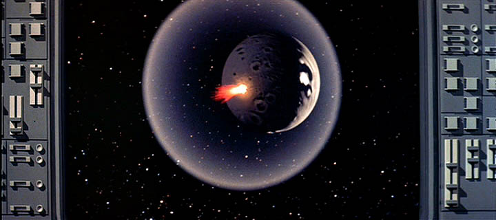

#14 David Mullen ASC
  • 20318 posts
Posted 03 May 2009 - 07:52 PM
Sure, for insert shots it is obvious that they are filmed off of a monitor, but when they cut to the "full screen view" that was still filmed off of a monitor? Really?
I've never seen, say, Star Trek II theatrically (and kick myself for missing it), but surely that wouldn't hold up on the big screen?
It does "hold up" but remember that this scene is playing on a monitor in Kirk's quarters and is a scientific simulation being played by the computer, so it didn't have to be overly photo-real even when it cuts to a full-frame image.
The Evans and Sutherland Digistar system being used (according to AC Mag, Oct. 82 issue) was designed for creating planetarium shows and they had built a display system that was 4000 x 4000 pixels for this work. But in this case, for "Star Trek 2" they used a high res computer monitor that was more like NTSC resolution, about 500 lines, but developed a system to increase sharpness and reduce aliasing (perhaps involving some multiple passes -- I think the monitor ran 60 fps but the VistaVision camera was shooting off of it at less than 1 fps, so they could build up exposure and perhaps fake some better resolution this way.)
They used this system to also create the moving star fields and some of the displays on the big screen in the bridge.
They later worked on "Last Starfighter" and claimed their film recorder was 6000 x 4000 pixels, but again, this could have been an accumulated resolution.
Also, these were b&w displays and color was created in multiple passes using RGB filters on the camera.
Now as for normal title over picture credits, doing it all digitally, including the compositing over picture, didn't become commonplace until the early 2000's. There were still places doing it on an optical printer when I did "Northfork" in 2002/3. Pacific Title, the biggest title house, had transitioned to doing them digitally right around them, though they were probably outputting text from computers to hi-con b&w film much earlier, maybe mid 1990's, and doing the composite over picture in an optical printer until film scanning and recording costs had gone done.
Here's a frame from the DVD of the Genesis simulation -- as you can see, it's not even full-frame but is composited into a monitor frame:
