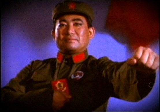

Here's one of the more stylized shots in the commercial (the rest were of the modern restaurant). This was taken against one of the walls of the restaurant with the director waving the red flag behind the store owner:
