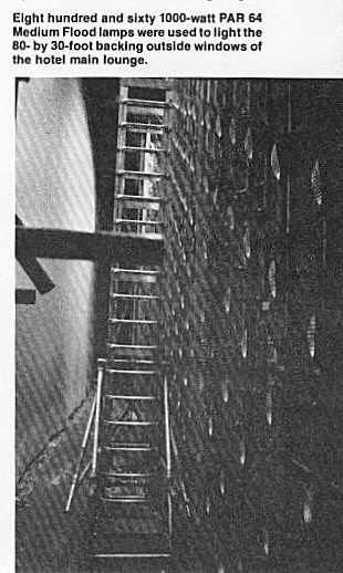

... a bit of a side issue - 'just been reading the Taschen/Kubrick book - he talks about lighting the interior set of the Overlook hotel - remember the beautiful diffuse sunlight coming through the windows? - they used a 100ft long white drape (he doesn't way which material) which was lit with 750 x1000 watt fittings - they literally created a wall of daylight - it looked beautifull and real... and simple.
nb David - what 1000 watt lights do you think he used? This was the early 80s so would they be daylight or tungtens gelled down or corrected in the grade? Interested to know what you think...

750?!? 3/4 of a million watts? wow. must have been an impressive sight. you ask what lights he used? without knowing and speaking totaly out of my a.. i would guess they built a rig for that. positioning 750 units would be a pain, and expensive. even using the cheapest lights you are still looking a lot of money. maybe they just got the fixtures for the bulbs and made a grid with them. i read that roger dekins mounted a bunch of 2ks on a piece of aluminum when he couldnt even fit tota lights in place. (big lebowski, scene where rich lebowski reveals the ransom note)
I bet it was a grid of 2ks on plywood or metal or something. but hey im still talking out of my a.. I have always had great luck with natural light, but then again I live in anchorage, so in the summer i get around 20-22 hours of light.

The AC article (Aug. '80) says that Rosco made a huge welded sheet of plastic diffusion similar to tracing paper (probably 216). The lights were 1K PAR 64 (medium floods). At some point in the story, the windows & glass doors were replaced with glass panes that had Full CTB (blue) gel sandwiched between two panes to make the light coming through to be much bluer.

.they used a 100ft long white drape (he doesn't way which material) which was lit with 750 x1000 watt fittings - they literally created a wall of daylight - it looked beautifull and real... and simple.
Rupe W
Rupe,
This is what I was thinking about (on a smaller scale) when I did the setup with the 8x8 silk. I got the idea from the Reflections: Twenty-One Cinematographers at Work. On page 40 there’s a window set that Owen Roizman lit with an 8K through a silk for a student workshop. I was surprised when it didn't work that well, but (as David mentioned) the silk fabric is not really appropriate for diffusion. Just when you think you know exactly what you’re doing, you learn something new. I was also surprised because I use the shoot-through-fabric technique all the time, though usually the fabric itself is not in frame.
