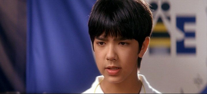

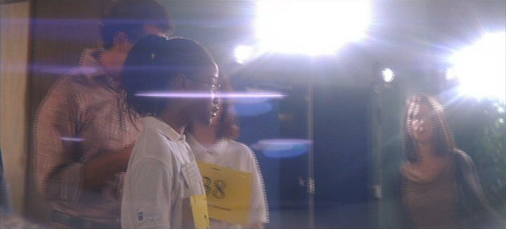

As I've been pulling frame grabs from "Akeelah" I've been noticing how bad some of the MPEG mastering is. Sometimes it even seems like the movie is switching from 480P to 480i because a few frames have toothcomb artifacts. And the compression on some moving shots is ridiculously high.
Bad compression on a moving camera shot:
Here's an enlargement:
Interlaced-scan artifacts:

That toothcomb-thing is standard procedure on most frame-grab DVD's, unfortunately. Sometimes you can de-interlace it with the video setting in Photoshop, but it doesn't always work. As suggested, it has to do with interlacing (interlacing, btw, is pure evil - they screwed video over for 50 years when they invented that s**t).
If you rip the DVD and use the files to convert to Quicktime films I can recommend a freeware software called JES DeInterlacer that's absolutely brilliant. It converts interlaced to progressive, and vice versa, better than anything out there - no jagged edges or aliasing. It's also THE only software that does a convincing PAL to NTSC conversion (or vice versa).

Generally speaking, DVDs of feature films aren't interlaced. The MPEG data in the VOB is 23.976p, flagged as 29.97 so the DVD player knows to add the 3:2 pulldown during playback (the hardware MPEG decoder does this on the fly). If this DVD was encoded as 23.976p (as it should have been), then the problem could be the flagging, or simply the DVD software you are using to capture the frames.
Seems like you only see very poor quality like that when they are trying to cram a bunch of extras in addition to the film on the DVD.
On the contrary, a progressive stream takes up less space in addition to looking better (24fps as opposed to 30fps).
Yeah, interlacing sucks, but you don't have to let it affect your post process at all. Films can be telecined, cut and authored all progressive scan. Interlacing only happens if the output device you are playing on is interlaced, and that is all done on the fly at the time of playback. You'll see less and less of this problem as progressive scan players and displays become more common.

Since you didn't do a DI on Akeelah (did you?) I bet they telecine'd the film to an interlaced format and then struck the DVD from that. It's too bad.
Even if it was telecined to an interlaced format (unlikely, considering there are HD trailers for the movie on Apple's site), the MPEG2 encoder would automatically remove the pulldown and restore the original 24 progressive frames before compressing them. Again, this is assuming the DVD was authored the way it should be.
I would have to rip and take a look at one of the VOBs for the main movie to know for sure.

The movie was transferred to 23.98P/1080 HD-D5 -- I know, I supervised the transfer. Of course, the DVD is made from a downconversion, but still, I've never run into this problem before in the last few years of grabbing frames off of a DVD. Most movies, if shot in film or 24P, are 480P on a Region 1 DVD. Only the behind-the-scenes clips tend to be 60i.

David- How are you grabbing the frames? If its software then they encoded with the pulldown or interlaced for some reason. If your running a DVD player output to a digital converter, you may just happen to hit capture during one of the pulldown frames.
As for the quality of compression-it does look pretty bad. I can't believe a professional DVD authorer would let a movie go like that. We compressed 'Nice!Gordon', a cheap snowboarding movie, with an equally cheap DVD authorer, and the compression was very good. I didn't notice much artifacting between the projected mini-DV premiere and the DVD.
Also a possible reason for the low quality could be a late-generation clone of a master tape (HD-CAM to Digibeta to Digi to digi to beta SP to DVCAM to SP to DVD authoring or something equally redundant.)
