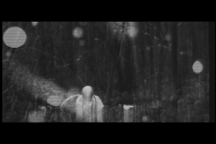

Ryan, is there any way you could post a single frame shot of the smearing, just to give me an idea?

#8 ryan_bennett
ryan_bennett
  • PipPipPip
  • 138 posts
  • Student
Posted 20 December 2006 - 01:14 AM
Smearing:
