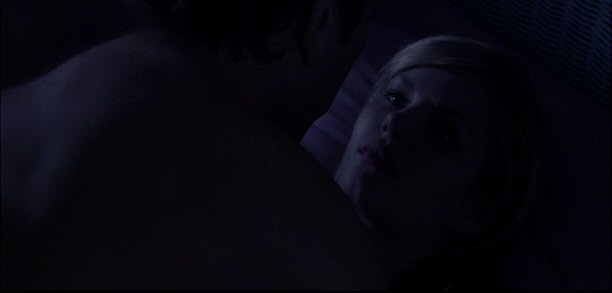

Here are some moonlit scenes in "The Quiet" that I shot in HD. Since it was an HD shoot, I didn't meter anything, but generally the highlights were around two stops under depending on the scene. I used smoke to lower the contrast, which actually adds fill into the scene, plus I usually had some dim fill light.
This first example shows the barest amount of fill light in the shadow areas -- you can barely read a glint in her eye in the shadow side of her face:

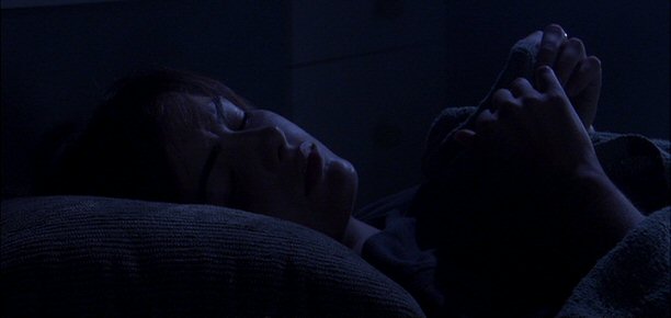

Here is another bedroom scene with minimal amount of fill plus smoke:
This last one, in the same bed later in the movie, was lit a little differently -- instead of hard moonlight through the window, I switched to a Kinoflo for a backlight inside the room for a softer backlight. Again, with fill and smoke:
