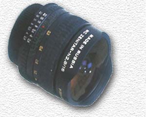

The Meteor lens that comes with the camera does not cover the Super 16 frame between 17-25 so you may want to look at another Russian lens, the Fisheye MC Zenitar-M 16mm f/2.8 Lens. This covers the Super 16 frame and even though it's called a fisheye, the distortion is not that great on a 16mm movie camera. The specs are at this site, so double check to see if it will focus close enough for you.
http://www.rugift.co...isheye_lens.htm
