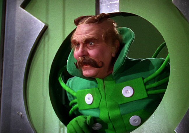

Here are two reference frames. I would collect as many as you can for matching purposes:
3-strip was a very slow process, so lenses were often shot wide-open (around a f/2.8) and there weren't really any wide-angle lenses, so most of the movie would have been shot in the 35mm to 75mm range, medium focal lengths.
Lighting was often hard with a lot of fill, but lenses were softish, and sometimes diffusion was used on close-ups (not always). Reds were soft, making skintones softer. Bright glints of light would halate with a reddish-lavender glow.
I think Schneider Classic Softs create this halation effect the most closely.
Production design, make-up, and lighting is key. Getting the focus to be shallow enough too.

What's interesting about some of the early 3-strip movies is that the close-up lighting is hard but not crisp -- it's semi-softened. Look at the close-up of Judy Garland that I posted and note the softish chin shadow.
Now considering back then, before 1938, you were talking about an effective 3 to 5 ASA probably, daylight-balanced, she is probably being lit with carbon arcs. So is the softness just due to a large fresnel lamp very close to her, or did they add some spun glass in front of the light for her close-up?
Some of the softness of the lighting is also due to the need for multiple lamps just to get enough exposure.

The above photographs of Wizard of Oz is very saturated. Is this due to the Stock? Can somebody explain Technicolour a little bit more. Is it a special stock or processing technique?

Well, you can't really judge saturation based on a frame grab from a DVD that I took through PaintShop Pro...
Technicolor was a very rich process, but not necessarily always saturated. They could control that some extent based on how much they flashed the b&w matrices and the dyes used in the imbibation print process.
