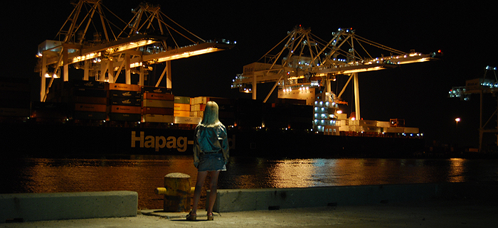

That same night, we shot a scene across from some loading docks at the harbor. It begins with a teenage girl waiting near the shipping docks. We had an overhead 5K gelled with 1/2 CTO on a condor pointing down for an overhead streetlamp effect and I filled in from a distance with another 5K with Cyan60 gel over a Chimera softbox.
Hi David,
It looks beautiful! The lights on the cranes on the boat, are they all practical or did you add lighting to it?

The boat and dock were just the real lights there, though from the Condor, I did shine one of the PAR64's onto the shipping containers -- it was so far away that it just added some weak fill.
My gaffer, Kevin Janicelli, always puts four or so 1K PAR64's (firestarters -- i.e. very narrow spot globes) in a Condor with whatever the main light is, just to pick out various spots from above, like a treetop or distant building. It's great because it adds some life way in the background.
On a condor at night, he also prefers using a big tungsten unit like a Dino or Maxilight rather than HMI's, and just gelling them for moonlight or a streetlamp color -- they are more sturdy & dependable than HMI's and don't require headfeeder cables, etc. We can turn off individual globes to control the intensity or swivel some globes for the spread. Of course, you do get a slight fringy shadow from a multi-globe source like that.

Ah! Hapag-Lloyd. Now they are a very farmiliar sight around Newcastle. :)
Beautiful shots by the way. You really are one of the ASC's finest. ;)

What are you shooting, that the light on the ships is bright enough?

I think the Maxibrutes were a mix of medium and spot rows, not sure. Cyan60 is just what I'm using for a faux mercury vapor color, blue-green. Actual mercury-vapor street lamps seem to be rendering a little more greenish than the tungsten with the Cyan60, but that's OK, cyan is green enough for me... It's a pretty color actually. I remember for "Shadowboxer" wrapping Cool White tubes with Cyan gel for a motel exterior and loving that color.
I shot the shipping docks at T/2 on Fuji 500 rated at 640 ASA with a one-stop push. But they were pretty bright in real life -- they use a lot of sodium vapor lamps on those cranes. I took these snapshots when I scouted the place, and the camera was set to around around a typical movie camera exposure time:
As soon as I saw the location, I knew we had to shoot some scene, any scene, with that backdrop.

Do you know what the equivalent Lee gel for Cyan60 is?
Rosco's CalColor line is a really interesting one, don't think you'll find an exact equivalent to it with Lee. Comparing the swatches, the closest match to my eye is Lee 131 Marine Blue which is a bit more dense than CC60 Cyan, and closer to CC90 Cyan.
That definitely is a fantastic vista to take advantage of David :)
