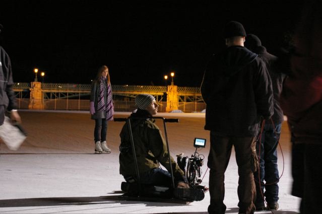

Hi! I just returned from Budapest, where I shot two nights on ice..
The crew made two simple metal plates with simple skates under them.. They also made a handle so that the grip (or myself) could run around on the ice with this 'dolly'..
Attached File  ice561.jpg   87.76K   9 downloads
It worked great.
_ras heise
