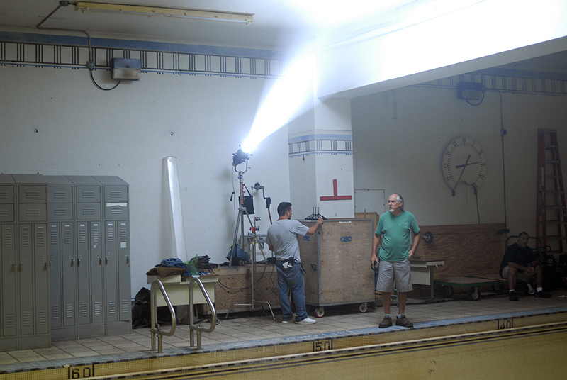

Here are some crew photos taken by Walter Thomson, our unit photographer. I was lucky that someone was taking photos of me at work because I end up with so few sometimes.

Key Grip Anthony Gamiello (left) and Gaffer Kevin Janicelli (right) at the swimming pool location, lit with hanging flos and one HMI Source-4 bounced off of the ceiling:
