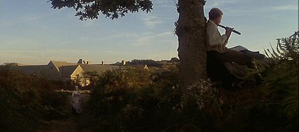

The most common diffusion-type filters (and an overall diffused look didn't really start to become popular until the early 1970's, unless you count Ozzie Morris' work in the 1960's) were Fogs, Low-Cons, and Double-Fogs.
All of which are still made and sold.
You also had Mitchell-type diffusers back then, and black nets of course.
Classic Soft, in some ways, is a throwback to some of the diffusion filters of the 1940's.
Low-Cons, Fogs, and Double-Fogs were all similar, just varied in terms of degree of halation vs. overall haziness, and softening. Double-Fogs really are Low-Cons and Fogs combined.
Good examples of Fog filters are found in Geoffrey Unsworth's films, particularly "Murder on the Orient Express", "Bridge Too Far", "Superman", "The Great Train Robbery", and "Cabaret". Parts of "Tess" (the parts he shot before he died.)
"1941" was shot with a Fog filter too. William Fraker did a lot of that sort of filtration back then.
Vilmos Zsigmond used Double-Fogs a lot, like for night work in "Close Encounters", and for "McCabe and Mrs. Miller". A Tiffen add from back in 1978 quotes Zsigmond as saying he used Low-Cons for parts of "Close Encounters", which he now tells me he doesn't remember using -- but when you pulli some day exterior work off of the DVD (like the driving scenes through Wyoming) you can see something is on the lens, probably Low-Cons but maybe Double-Fogs.
Much of "E.T." was shot with light Double-Fogs.
An example of a Low-Con would be "Barry Lyndon".
"Bound For Glory" used different filters, from Low-Cons to Fogs to Brown Nets (pantyhose).
"Fiddler on the Roof" was shot mostly with a brown pantyhose over the front of the lens.
Here's some Fog-filtered shots from "Tess":
