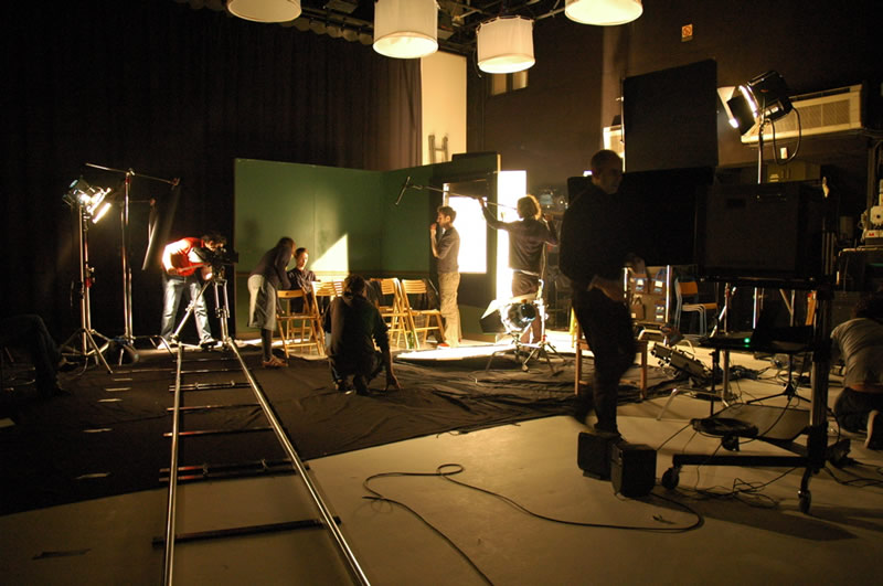

Here is a still from a shoot I did last weekend that sounds pretty similar to yours, only I went for a more late afternoon look as opposed to sunset.
First off, I would say make sure you get a great hazer, one of those cracked oil ones that put out a very fine haze that hangs around for ages. Expensive, but worth every penny. We had cheap party foggers and they drove me nuts and didnt work out in the end. They banged out far too much smoke at first, and when it started to settle and disipate, boom, it was gone. The film was one 10 minute take, so obviously by the time we would get to the end of a take there was nothing left! So i ditched the foggers and just lived with no smoke, which I was obviously upset about. This still was taken while i was still trying to make it work!
Besides the smoke it was just a 10k through the window as far back as i could get it for the pattern of the blinds on the wall, a direct tweenie through the window for her hard side key, and the rest were 2k skip bounces to provide directional fill on her and model the face a little more, and bring up areas of the set where necessary. The thing i love about interior sunny days, especially as the sun is going down, is the way hard light bounces off floors and walls etc to create lovely soft sources from where ever the hell you like! They can be more directional than creating ambient fill and still feel natural.
