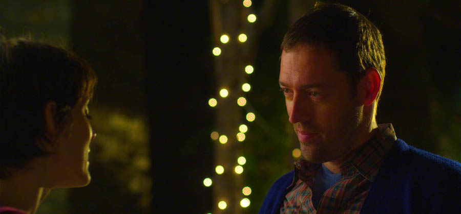

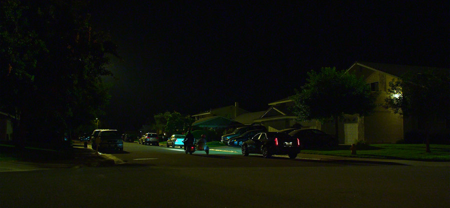

Here are some frame grabs from "Stay Cool", the last RED feature I shot. The first two were shot at 500 ASA, output at about 3800K balance:
This one was at 400 ASA, 3800K:
While there IS some noise, I don't think it could be labeled as "too noisy for feature use" -- the noise isn't any worse than the grain of shooting on 500T film stock.
Yes, I wouldn't say that the RED ONE is the best low-light digital cine camera on the market right now -- it's closer in behavior to its nearest cousin, the ARRI-D21, also a CMOS Bayer-filtered imager. I think the Sony F23, F35, and Genesis probably all behave better in low levels of tungsten light, noise-wise. But I certainly think you can shoot the RED ONE in those conditions if you know what you are doing.
