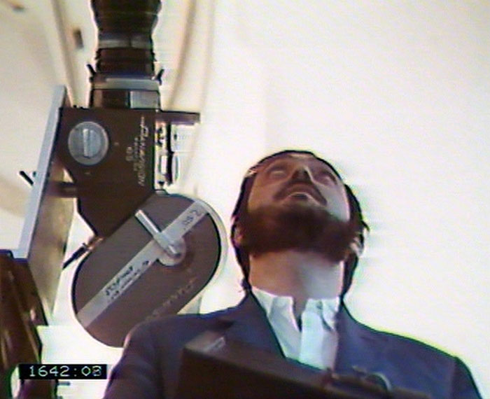

I've been viewing the documentary, "Stanley Kubrick - A life in Pictures". In the sequence on "2001..." he is briefly shown carrying a rectangular hand-held Panavision camera. Any of you know what that camera is (was)?

Darn...I had the DVD as a rental and I just returned it today (however, I am going to buy it). Anyway, I recall there was an actual motion shot on the set of the revolving space station. Kubrick had the camera in hand.

#15 David Mullen ASC
  • 20074 posts
Posted 02 January 2009 - 01:13 AM
You can see some different Panavision and Mitchell 65mm cameras here:
http://www.widescree...een/wingsp3.htm
Here is that handheld 65mm camera used in "2001":
I believe you can see the same unit on this page:
http://www.in70mm.co...5mm/gallery.htm
The Panavision 65mm handheld camera supposedly came out in 1968, too late for Kubrick on "2001", though either he got a prototype to use or this was built by Mitchell or someone (probably the Panavision version was just an adaption of that then.)
Photos from "2001" show a number of 65mm cameras used, including a Mitchell 65mm for non-dialogue shooting and efx shooting.
The movie itself was not shot in 35mm... but 35mm could have been used in various places for efx work or some footage for the rear-projected screens on the movie sets, and even in some of the miniatures that had projected elements. That's probably why 35mm is credited for some of the movie.

...I believe you can see the same unit on this page:
Are you referring to the camera behind? In that picture he is holding a Panavsion "something" :rolleyes: . That's the unit I was curious about.

:rolleyes:
Hi-
That's an old Mitchell (or I guess Panavision-branded in this case) viewfinder.

Posted 28 August 2012 - 01:48 PM
FYI...
