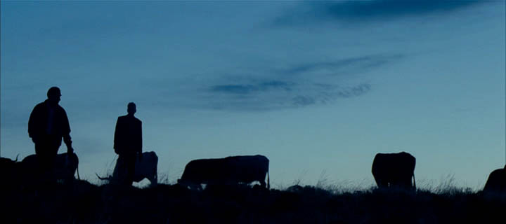

"Magic Hour" just refers to the time right after the sun has disappeared behind the horizon when there is still light in the sky. Here in California, because we are closer to the equator, it's more like 15 minutes, not an hour -- we sometimes refer to it as "Tragic Hour" because it's so stressful to cover any scene in under 15 minutes, and the levels change radically every take. You can be at f/5.6 on Take 1 and f/1.4 by Take 4.
I did a movie in Canada last year where we had a Magic Hour sequence and I was rushing like hell to get all the shots needed... and after 45 minutes, there was still enough light to shoot! The Canadian crew was looking at me like I was crazy because I was pushing everyone so hard to get as many shots done as possible in what I thought would be a 15-minute window.
By the way "Days of Heaven" was shot in Canada, not the Texas Panhandle -- made shooting all those Magic Hour scenes a lot easier I bet.
"Magic Hour" can be depicted as quite blue-ish in some movies because DP's often pull the orange 85 correction filter normally used when shooting tungsten-balanced stock outdoors in daytime, to gain speed. You can see in "The Conformist" a lot of Paris is shot that way, with a blue-ish cast to the light in contrast to the warm lights of stores. "Last Tango in Paris" opted to let everything be on the warm side however.

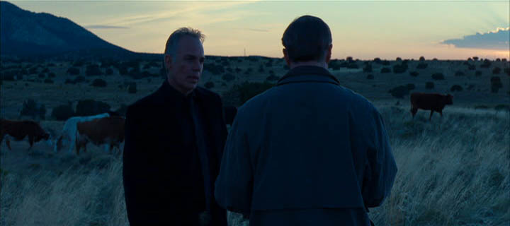

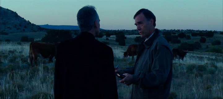

I had a magic hour sequence in "The Astronaut Farmer" (shot in New Mexico). I only had time to shoot three angles, the widest shot done last because I only needed enough light to get a silhouette against the sky, not expose the faces. Also, the two closer shots were done simultaneously with two cameras shooting cross-coverage:
