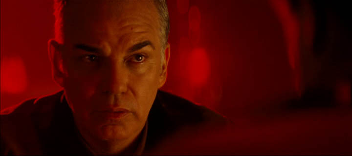

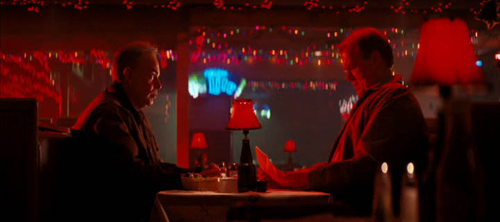

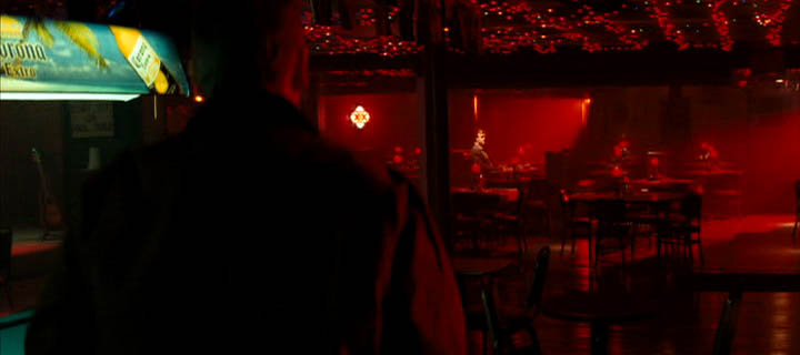

Red wavelengths tend to go out of focus, I don't know why. It doesn't help that most video display systems devote so little bandwidth to red info as well. I have these frames from the DVD of "Astronaut Farmer" which show how I tried to mix some orange keys into the red lighting (in a smoked bar location) to provide some relief and some sharpness:
You see the blockiness of the red-lit guy in the second frame, something to do with the DVD compression.
The bar was called "Red's Branding Bar" so I just took the liberty of using red light in there, and art department added red Christmas tree lights to help further. But I rarely actually lit a face frontally with red light because it just tends to look out of focus, especially on TV later. I love finding excuses though for red backlighting or accent lights on things.

Hey Dave, I have to say that is some of the sharpest 'Red' (and I don't mean the camera) I have seen in a long long time.. congrats to you, lab, colorist and overall technology for helping us (all) get this thing under control. The wide two shot in the booth is a great example of the color Red... under control.
What format/ Stock was that shot on.... a preliminary google turned up nothing but DVDs for sale... ??

That was Fuji Eterna 500T, rated at 320 ASA, Panavision Primo anamorphic lenses at T/2.8.
One thing to remember about scenes under heavy colored lighting is that you don't want to expose the color "at key" because it would then actually be overexposed and washed-out at that point. To hold the deep color, the light is generally a stop under or so. If you looked at the colored lighting on a b&w monitor, you'd hardly notice the red edge light for example, because it's not very bright in terms of luminance, but in color, it's very obvious.
