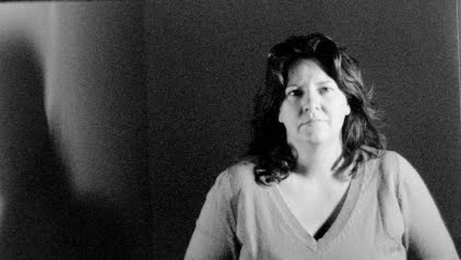

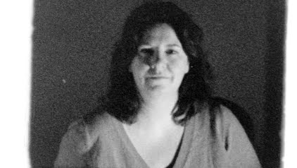

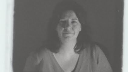

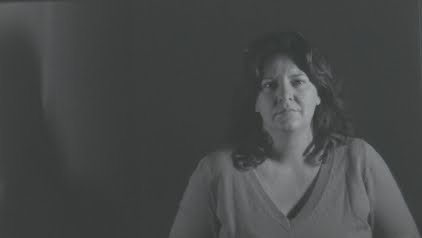

My results differ from the previous poster about cross-processing. I scan lots of tri-x cross processed here at frame discreet and it has a much lower contrast (wider latitude) than reversal film. That's why I always cross process my tri-x (unless I need to project it). Cross processing gives me more shadow detail and more highlight detail (at a sacrifice of a grainier image, which I quite like).
Maybe the other poster wasn't able to supervise his transfer to see how much range there really is in the cross-processed image?
Best of Luck!
oh attaching some samples.
tri-x from BELLADONNA, our raw 2k scanner.
SUPER 8 and SUPER 16.
First image is the FLAT scan with no correction. Second Image is with a contrast and gamma adjustment to give it more of a 40's film noir kind of look. (the super 8 was under exposed by 1 1/2 stops so not as much latitude in the shadows- and a little softer than normal).
