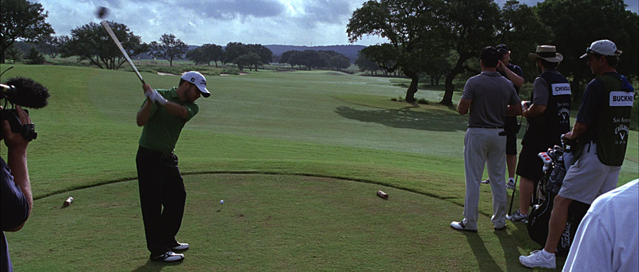

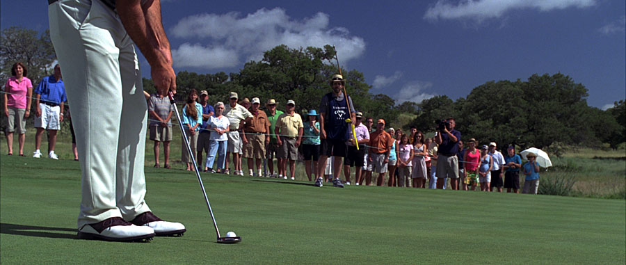

I can't do this too often, but here are some general examples of frames from the dailies, reduced and compressed, etc. keep in mind. I tweaked the blacks a bit and added a touch of sharpening to compensate for reducing the size, and I asked for this particular scene to have a colder color cast, most of the movie will be timed on the warm side. The aliasing is probably coming from being a grab from a 1080i signal I'm guessing, since this is film there is no aliasing in the original.
This was from the morning of the first day before I lost all the clouds in the sky for the rest of the week.
