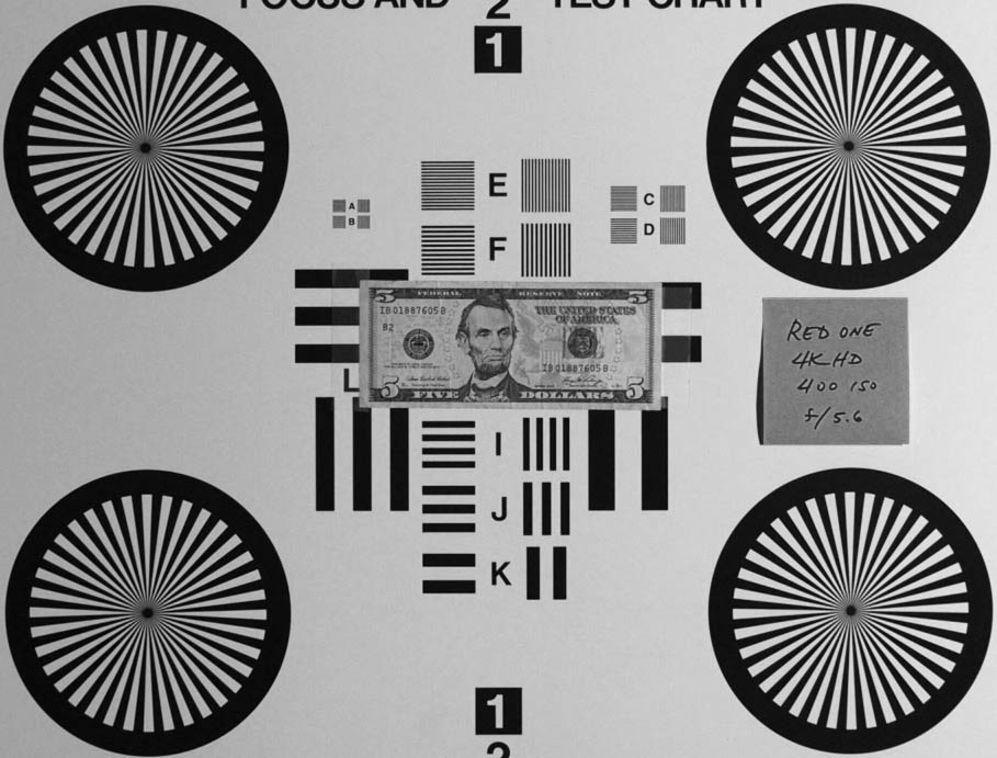

I posted these before, but look at these tests I did between the Canon 550D T2i, the Sony EX3, and the Red One reduced to 1080P:
All cropped to a small area to show the sharpness differences:
Canon
EX3
Red
You see that the Canon is not only soft but above a certain point, detail is actually just aliasing.
