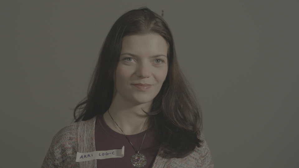

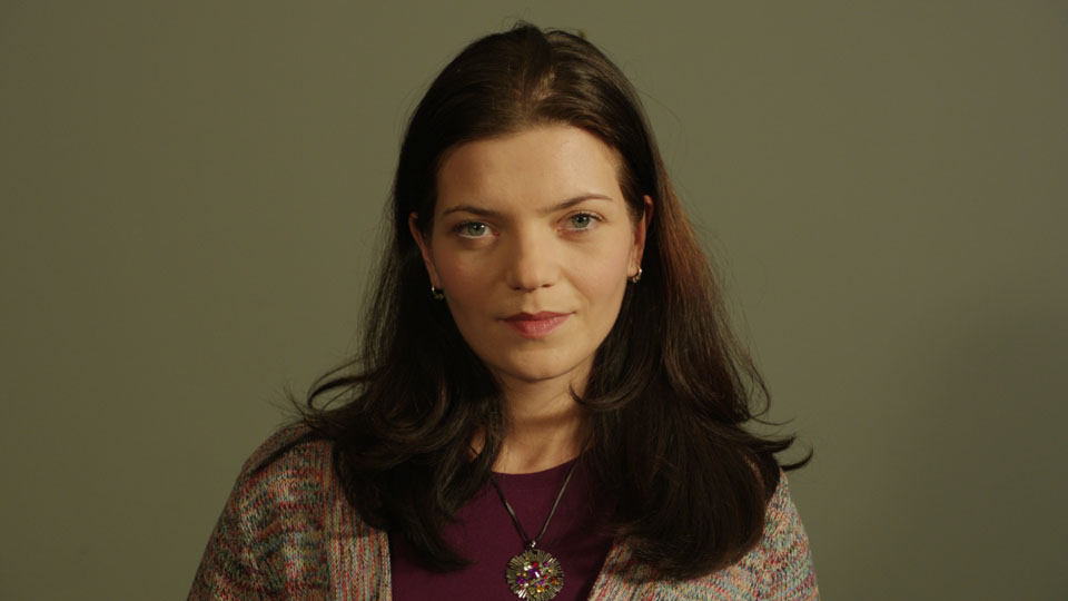

#5 David Mullen ASC
  • 20069 posts
Posted 28 January 2011 - 01:53 AM
I went over to Clairmont Cameras today and shot a quick test, a shot of a DSC Labs 11-step chart and a face (the attractive receptionist at Clairmont), both in Log-C and in Rec.709. The idea was to take the footage over the Technicolor Vancouver and create a basic Rec.709 LUT that I could apply to the Cinetal monitor on set and to dailies. But I also shot a version with the camera's internal Rec.709 conversion just as a basis of comparison to what I was going to create. I did something similar when I shot the pilot for "The Good Wife" here in Vancouver on the Genesis camera.
While we were shooting, Chris, the tech at Clairmont helping me, grabbed some frames on the Cinetal monitor while I was rolling, a nice tool (I hear the beta firmware upgrade will allow the camera itself to do frame grabs).
Here is a Log-C frame:
Here is an in-camera Rec.709 version:
I reduced both frames by 50% and compressed as JPEG's them for the web, so don't analyze them too seriously... And as for lighting, I just had two 2K Zip lights, one for key and one for fill, pretty crude.
We shot the footage in Apple ProRes 4444, which is what the studio post people asked me to do. 800 ASA / 3200K.
I ended up creating three LUT's from the one test, using my DSC chart but then checking how it looked on the shot of the face. At Technicolor, we found ARRI's Rec.709 in-camera conversion to be a bit yellow and saturated, so our version for Rec.709 display is a bit more neutral. I also made a slightly more contrasty LUT for scenes shot in smoke or really flat weather, and a third LUT just for a few flashback scenes that is slightly desaturated.
What was interesting to me during the shooting of the test was how Log-C looked on a waveform. I'm used to PanaLog, which is a fairly mild Log emulation, where white on an 11-step chart is 70 IRE and black is between 5 to 10 IRE. But Log-C from the Alexa was a lot flatter, I mean, white only hit 60 IRE and black was almost lifted to 20 IRE. I thought maybe the waveform was miscalibrated but it turns out that because of the extended dynamic range of Alexa, it can hold a lot more steps over the white patch on the DSC Labs chart, and more steps of shadow detail as well, hence why the 11-steps of the chart occupied just the center band of the waveform. It's pretty amazing in terms of dynamic range.
The image is also very clean at 800 ASA, and not much noisier at 1600 ASA.
Apple ProRed 4444 is something like 360 Mb/sec, not far below HDCAM-SR's 440 Mb/sec. It looked pretty good in the HD bay at Technicolor. General opinion seems to be that it is close to HDCAM-SR quality, more or less, though the color info and sharpness seems a bit more compressed if you look really hard or are trying to grab a subtle color for a key during color-correction.
It's a bit weird to be shooting in a high-end HD format that you can just play directly on your laptop right off of the SxS cards (well, it played on Chris' new 17" MacBook Pro; my 6-year-old Mac laptop would probably just choke on it...) I was even able to put my Apple ProRes tests on my personal flash memory stick because it only took up about 3G, and took that over to Technicolor for downloading into their system. How times are changing...
