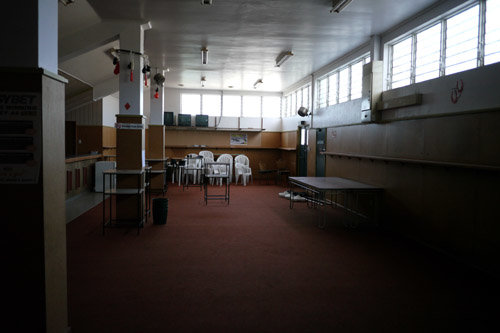

I was wondering if anyone had any tips on how to light the attached scene. It is a pub which I will be shooting during the day. There are fluroescent lights in the building, which I want to try to avoid using. Action will be happening on the floor of the pub, but most of it will be at the bar. Because the bar is so far away from the windows, the light is going to be very flat. Is there any way I can subtly shape the light on the talents' faces? I am keen to use the windows as the main light source, with natural light if possible. In fact I want a very natural look - I only want to subtly shape it.

I should also say that I do have access to lighting. Not HMI's unfortunately, but kinos, gelled tungstens etc. Also plenty of flags, bounce etc.

I'd start by flagging off half of the windows so that the bar is more 3/4 instead of frontally-lit, then wrap that more from the side with the Kinos.
You could imagine that the daylight is dim enough at the bar to allow some practical lighting behind the counter.
You could also create some slashes of hot sunlight with some Joker 800 Source-4 Lekos if you could rent some.

Thanks for that... I thought about practicals hanging above/over the bar. I don't have a lot of experience mixing different temperature light sources and I'm worried that if I hang practical tungsten lights my talents' skin tones will be orange and unnatural.

There are blue-dipped photofloods that are more like 4800K, so only slightly warm-looking. Or use daylight compact flos and daylight tubes in the bar.
