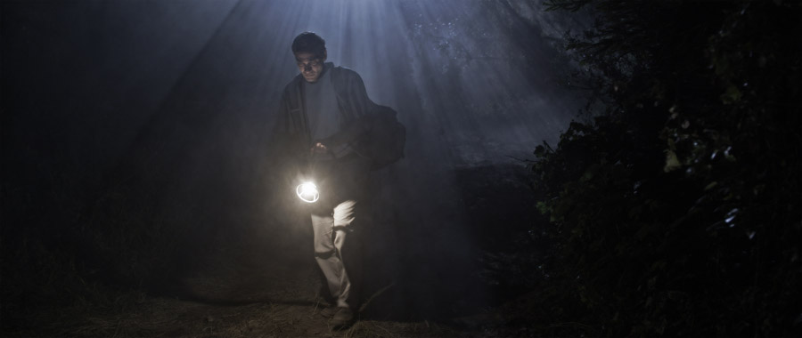

The night ended with the trail in the woods that I lit with the 18K HMI on the far hilltop above the canyon, plus a few Kinos for fill. For a handheld close-up, I also had my little Micro Litepanel on the camera for a weak amount of fill. We ended the night with a few shots done with my lensbaby on the camera, for a nightmare vision that Jack has while wandering in the woods.

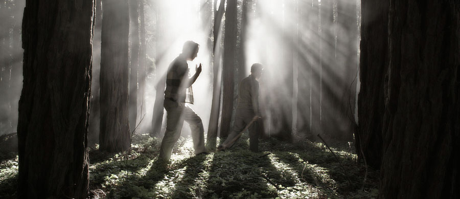

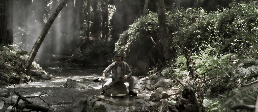

A few frames from our last day in Bixby Canyon, when we ran around with our actor and a camera, working our way downstream back to base camp:

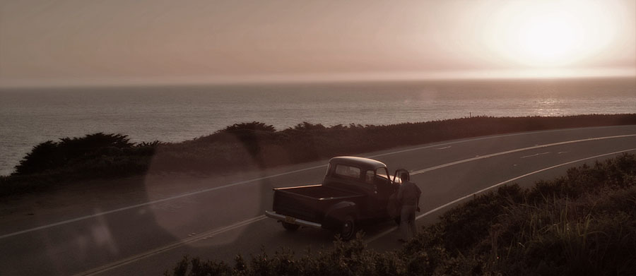

By the end of the day, we got back to Bixby Bridge for a dusk-for-night shot, but we managed to get this other scene where Jack gets picked-up by a truck near sunset (any banding around the sun is due to my Photoshop files, not in the original). I was happy that we managed to grab this shot so quickly:
Even the tighter B-camera shot on the 135mm Ultra Prime turned out pretty well for a last-minute set-up:
We shot until the last bit of magic hour for this shot. I added some stars quickly in Photoshop. It was too windy to raise any sort of lights to shoot this night for night, plus there are too many restrictions on pointing lights at drivers along Highway One, so it had to be done at dusk for night:

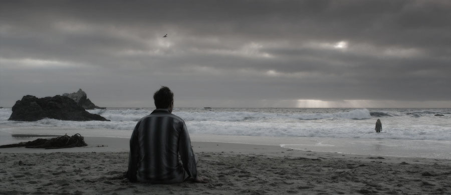

Some frames from the second to last day, the last day with the full cast, at the beach under Rocky Point Bridge. The first and second shots show why we picked Rocky Point Bridge instead of Bixby Bridge for the scenes underneath, even though Bixby Bridge is slightly bigger/longer -- first, you can see the Rocky Point Bridge from a distance as you walk up (Bixby Canyon is choked by trees and brush right up to the ocean), and second, there's some actual beach area to walk around (and you can drive up to within 100 yards of the ocean, not hike in for 20 minutes as with Bixby Canyon):
That last shot was done just before we broke for lunch at 4:30PM -- when we got back, we finally got some moody weather, which was great for this scene where Jack is thinking some dark thoughts:
Only trouble was that now we had freezing winds to put up with...
We ended the day on the beach for a bonfire scene -- you can see how strong the wind is from the way the bonfire looks:

can you describe your lighting set up on that last beach set up.
#55 David Mullen ASC
  • 20309 posts
Posted 14 May 2011 - 11:23 PM
There was an 18K HMI on the top of the cliff in the background with two doubles in it (I could have probably gotten away with a 4K HMI but I didn't know how far it would be). I took a 1.2K HMI way off on the right side of frame and raked the wall of the cliff so it wouldn't go black. The people are lit by the real fire. There is some fill from 4' 4-bank daylight Kinos near camera.
I had two orange-gelled 1K Woodylights off camera left, not to light the people, but pointed towards the camera in case one of the actors walked all the way to the foreground, so they would have an orange edge-light on them. But they never did so those orang lights weren't really doing anything in this shot.

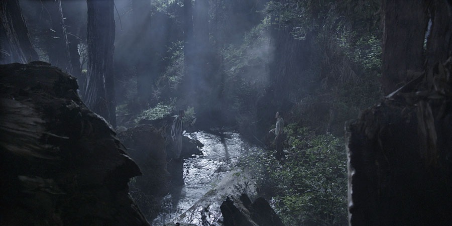

Would you mind explaining your exact lighting instruments for the moon lit shot in post #52?

The main problem with lighting the woods is that trees can quickly bloke up your far-off moonlight source. So basically I had to use a couple of units separated by a few feet to get through gaps between trees. At the top of the frame, up a steep hill, we managed to get one 4K HMI and two 1.2K HMI PAR's. I think it's the 4K that managed to get through and light the main area where the two guys are standing, and the two other 1.2K HMI's hit the river further in the background. Up the hill on the left side, off-camera, was an Image-80 Kino, and up the hill on the right side was a 4-bank Kino, all daylight. Then in the foreground, behind camera, was a 4-bank Kino that was flagged a bit off of the foreground tree trunk.
Way, way in the background, down the canyon and then up the access road that came down into the canyon, I built two levels of parallels and put a 12K HMI PAR on it... but after we struggled to get it up there and turned on (it was acting up), it turned out that, despite being up the next hill, it was still downhill of where we were shooting, and it was so far away and so blocked by trees that all it did was put a tiny glow in the top middle-left corner of the frame -- in truth, if it hadn't been for all the trees, the unit would have been in the shot anyway. But with the smoke, it did create a bit of separation in that small area. But it wasn't worth the effort. I had hoped with it being way down the canyon, it would have created more depth but it's really hard at night to judge distance and to see where the trees are that are blocking the light.
Funny thing is that way back where the 12K HMI was on the parallels, just above it, was Highway One -- a bridge was built over this canyon. It would have been great to use the highway bridge to light the back end of the canyon from, but that wasn't possible without closing the highway since the bridge had no space on the sides to pull over. Trouble with the Big Sur coastline is that it is basically a one road area, Highway One runs north-south with almost no east-west roads crossing it.
Here's a brighter, uncropped frame that makes the lighting more visible (ignore all the jpeg compression artifacts, they aren't in the original):
