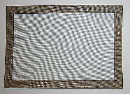

#8 David Mullen ASC
  • 20105 posts
Posted 08 April 2012 - 09:40 AM
Here's a photo of a homemade 4x5 net filter:
