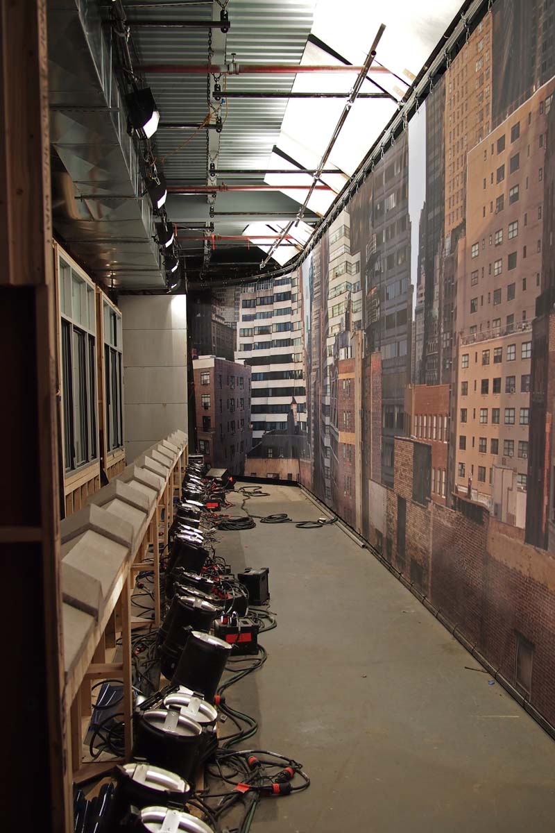

Generally to recreate daylight on a set you need a combination of hard and soft light coming through the window -- the soft represents skylight and the hard represents the sun, and you can obviously just have soft light with no hard sun coming through, but often you want some soft light coming through even when the hard sun is coming through.  You also need lights to light any backing outside the window, even if it is just white.  You would normally minimize use of practicals as a source inside because seeing them turned off is one of the visual clues that this scene takes place in daytime.
It would be very hard to do all of this if you only have two or three 20A household circuits in the barn, unless it's just one window.  Yes, you can start out with the most power efficient lights -- LED's & Kinos for the soft, HMI's for the hard -- but even then you may be running out of power quickly.  For a small window, a 575w HMI would work fine for a hard sunlight effect, but if the window is larger, it will have to be backed-up to fill it and it may not read bright enough for full sunlight unless everything else is knocked down in relation and you use a fast lens or a higher ASA.  Of course, you could justify a "spotty" patch of sun, pretending it's coming through a gap created by two buildings, etc., that doesn't fill the window frame, and then compensate with the soft skylight effect coming through...
I had space limitations on a set built inside a warehouse with 13' ceilings -- to create the soft skylight we put bounce cards at the top of the ceiling at an angle and tungsten PARCAN's on the ground pointed up at them.  There were also some lights along the air conditioning duct pointed back at the translight backing.  For hard sunlight, I had to use lights on stands (generally a 5K PAR or 1.2K PARCAN firestarter), but sometimes I could rig them to the ceiling:

I'm guessing outside the rehersal studio for "Smash"? If so, it played quite well.

Thank you, David. A perfectly illuminating reply (if you'll forgive the pun) and that picture is worth a thousand words.
