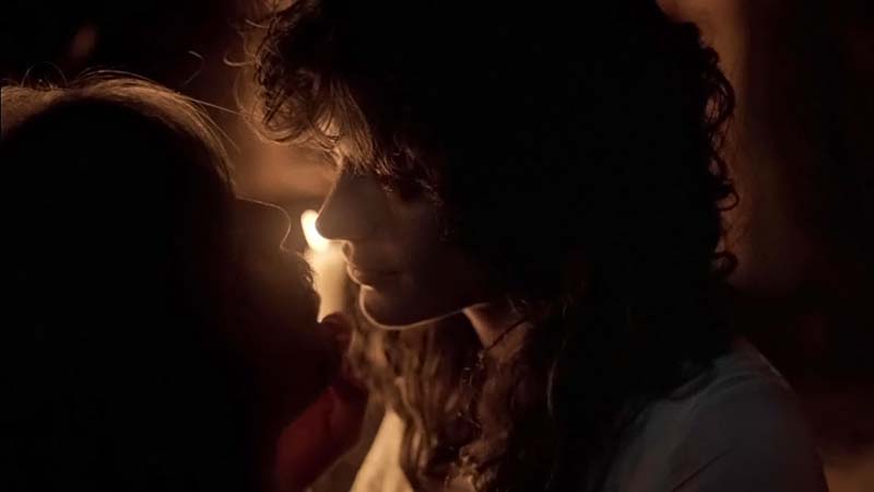

The general approach in romantic scenes has been to cross-backlight, today with soft light.  I did a scene in "Twin Falls Idaho" like that -- I hung a 4-bank Kino over the bed as a soft backlight and then put a small Kino on the floor to get a little light back up on the actress' face:
I did a similar thing here for a love scene in "Jennifer's Body" except without the light coming back up on the actor facing down:
Here is an ECU of lips from another kissing scene in the movie, both actors were sitting up so the cross backlighting was coming from each side rather than above and below:
In some movies where the actors are horizontal, the top backlight is bright enough to bounce back up onto the face of the actor facing down.
The problem with this traditional approach is that it looks best at the moment before the kiss because once the actors get close enough, they shadow each other.  Which at that point, either you go with a silhouette or very dim fill light. But once two faces are locked in a kiss, there isn't really an angle to get light on them other than frontally, which is a bit boring, hence why you often let them go dark at that point.

#5 David Mullen ASC
  • 20471 posts
Posted 27 October 2014 - 08:19 PM
Some screen kisses in film history.
"Gone with the Wind", again crosslit, him in red, her in white:
"Cabaret" -- there's a crosslight here, meaning that Michael York is edge lit by a tiny lamp on the floor:
"The Duellists":
"Dick Tracy":
You see the shadowing as people get closer:
"Blade Runner" -- Harrison Ford isn't even lit, just silhouetted by some background area that is lit:
Of course, most of these examples are profile 2-shots, i.e. 50/50's, which works not just because it's the only way to see the lips during a kiss, but it gives equal dramatic weight to both characters, creating a connection.  You can shoot kissing in over-the-shoulders too, it's just that at some point, the person leaning in will block the face of the person they are kissing. In this shot, it works because he's kissing the side of her face so we can still see her expression:

In theory the 50/50 angle which allows you to see the kiss isn't any character's perspective (unless there is a third character in the scene) so it becomes less subjective in one literal sense.  Trouble is that to shoot a kiss from one character's perspective, once the person leans close enough, you have no view of the person nor the kiss itself.  One of the more subjective kisses in cinema was Grace Kelly's first close-up in "Rear Window", where she leans right towards the camera (Jimmy Stewart's POV) but then Hitchcock cuts to the profile angle to see the kiss itself.
Kissing scenes can become very technical to shoot, other than the shadowing problem, there is the issue that usually one actor has to tilt their head to one side or the other, which again can affect the over-the-shoulders, there can be focusing issues, etc.  You start to learn though that you want to stretch out the moments before and after the kiss when the actors are making eye contact because at the moment of the kiss, you can hardly see anything.
