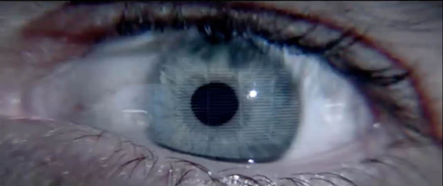

And I also had a shot like that in "90 Minutes in Heaven" -- I screen-grabbed this off the trailer that's online so it's rather compressed, but here is the brief flash cut to the eyeball:
During a crash sequence, I shot a truck driving right into a GoPro (which has a natural wide-angle distortion) head-on.  I shot the eye with the 290mm end of the Optimo zoom with a diopter. You can still see the bright white dot of the light used to light the eyeball, which I guess could have been painted out but it's a flash-cut.
You can also see the chromatic aberration from the diopter, which is why I used a 200mm macro on my next movie to shoot the eyeball shots.  And you can see the focus problems I had even at around f/8-11 at 290mm.

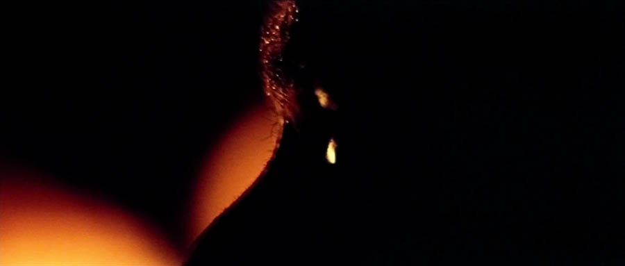

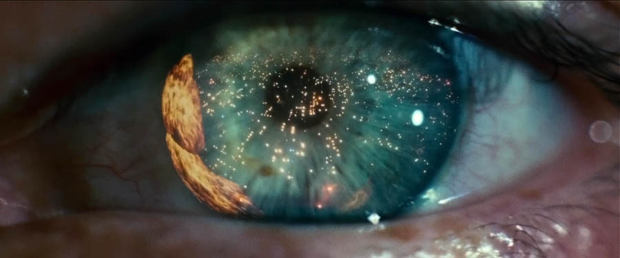

Here are two examples:
Composite:
Real reflection:
The first, from "Blade Runner" is interesting because the eyeball itself is a still photograph, it doesn't move, making it a lot easier to do a lock-off composite.  You'll find that with macro shots of people's eyes, even the slightest head movement is really bad for framing and focus, you practically have to clamp the head down or at least, get them to firmly press their head against a wall or something stable.  And you need a lot of light to stop way down, and even then, you'll have to decide if you want the surface of the eye to be in focus, or the iris of the eye, which is deeper, you can't hold both even at f/16.
So for "Blade Runner", the reflection was one of their landscape shots with the fireballs going but projected onto a round white dome to create a fish-eye distortion before being composited over the eyeball frame.  Today there are plug-ins that will create a fishbowl distortion to a shot with a lot of vignetting.
The second shot is from "Apocalypse Now" and is a real fire being reflected on a real eyeball but from a profile angle.
