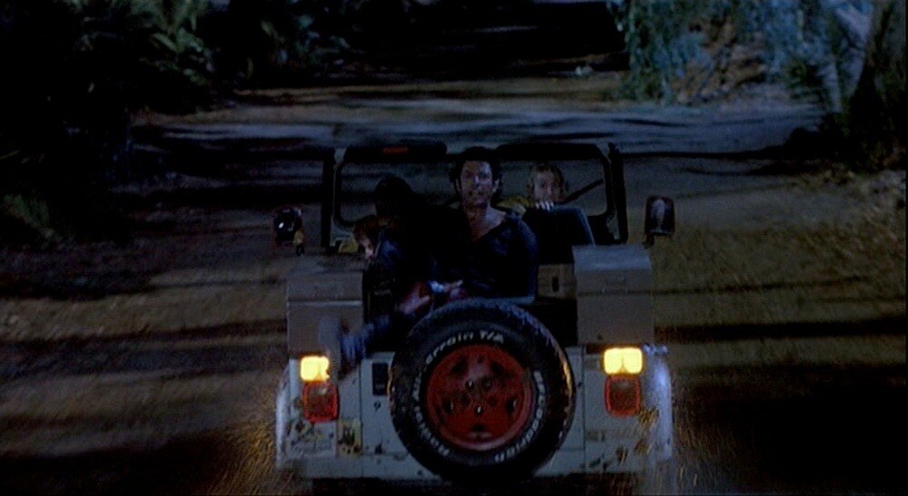

I've been looking at Dean Cundey's work on Jurassic Park and of course Kaminski's work on The Lost World. How do you think this and this were lit? It's similar to the look I want to find for my own short. It's very different to this shot, which always looked like it was lit by the park's own "service" lights at the side of the road, much like street lights.
Thank you all for your help so far, it's really interesting to see how the A7S is handling moonlight. It's going to change low-budget filmmaking, that's for sure. Love the look of that scene David - what project was it from? :)

The size/power of the HMI's will depend on the ASA of your camera and the distance of the lights.  These days with digital cameras, a 1.8K HMI ARRI is pretty useful at night, similar to what you'd do with a 4K HMI on film, but this is assuming you can rate your digital camera at 1000 ASA or higher.
The other problem is the height -- the more you want to get a backlit effect, the higher the light has to go into the air to get out of the shot.  If you are stuck using light stands, then it is better to go for a side-light effect, unless you are lucky with a convenient hilltop nearby at the perfect spot for a backlight.
That race along the road with the T-Rex is a perfect example of having to side-light because the length of travel would be too great for a backlit angle, you'd end up driving towards the light and seeing it in the top of frame at the beginning and ending up at the base of the condor within a block and a half of driving probably.
That low shot of the jeep pulling up was backlit from high to light the rain but also edge/back lit from the left on a stand to highlight the side of the car.
The low wide shot of the jeep at the top of the waterfall was edge/back lit again from a light on a stand behind the hill but a huge light on a condor probably was side-lighting the hillside waterfall.
My shots were from "Jennifer's Body".
