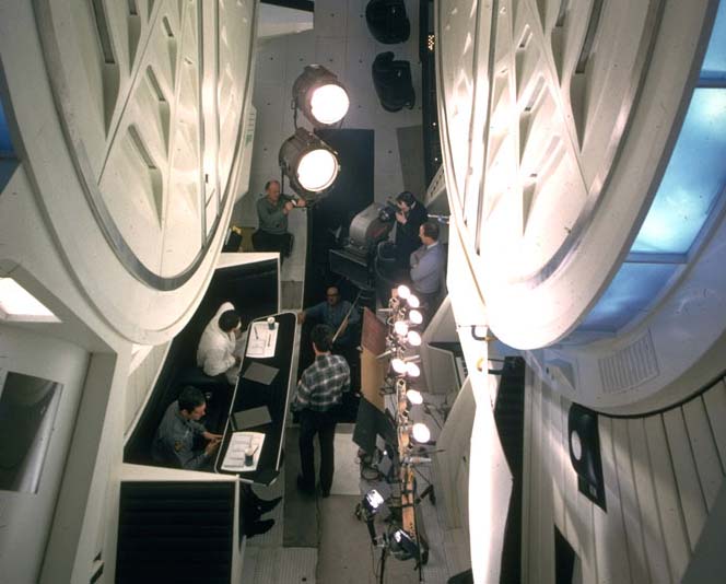

Some great photos of the sets being shot.  I've always been fascinated about how fluorescent lighting was often faked with large tungsten units or globes hidden behind frosted panels back in the days of 50 ASA film in the 1960's.
The photo of the lighting set-up in the centrifuge set suggests that Kubrick wanted any additional lighting to be bounced - you can see some large mushroom globe bulbs in reflector housings bouncing into white cards, but I suspect in the end, Unsworth had to roll in two 10K's to augment the bounce further for this set-up.

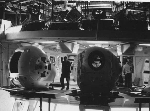

Interesting a Mitchell BFC 65mm which sort of confirms that Todd-AO lenses were used on this .And then on the high shot with the 2 x 10K's a Panavision 65 mm .
#3 Tyler Purcell
Tyler Purcell
  • 4192 posts
Posted 06 December 2015 - 01:48 PM
I think the Mitchell was used for the 35mm insert shots of their discussion which are square.
That's my thought on why that camera was there.
#4 John Holland
John Holland
  • 2283 posts
  • London England
Posted 06 December 2015 - 02:00 PM
Maybe but I think it would have been easier to shoot everything in the same format .I don't know wish I did hope someone else knows .
#5 Tyler Purcell
Tyler Purcell
  • 4192 posts
Posted 06 December 2015 - 02:47 PM
Well, they did use Todd AO lenses on it for sure. They also absolutely used Mitchell cameras, almost all of the BTS images from the end of the film in that white room, are of Kubrick with a Mitchell body, same with the centrifuge scene.
Maybe I'm mistaken about which shot that is... maybe it's the bug-eye shot of Hal looking back at the two of them? Which would be a Todd AO bug-eye lens.
You could be right, the insert of the screen could have just been taken from a 65mm interview.

#7 David Mullen ASC
  • 20157 posts
Posted 06 December 2015 - 03:40 PM
Todd-AO 65 and Super Panavision are the same format, so I'm not surprised if a mix of cameras were used.  I'm sure 16mm and 35mm were used for some material to be projected onto screens, plus tests.

#8 John Holland
John Holland
  • 2283 posts
  • London England
Posted 07 December 2015 - 03:46 AM
I have never seen that still with the Todd-AO camera and Bug Eye lens thanks .
#9 Mark Dunn
Mark Dunn
  • 2763 posts
  • London
Posted 07 December 2015 - 04:56 AM
I don't think the top one is a BNC- is it a BFC with the mag blimp off? Or maybe as this was the first scene to be shot  they hadn't got round to putting the Panavision stickers on.
