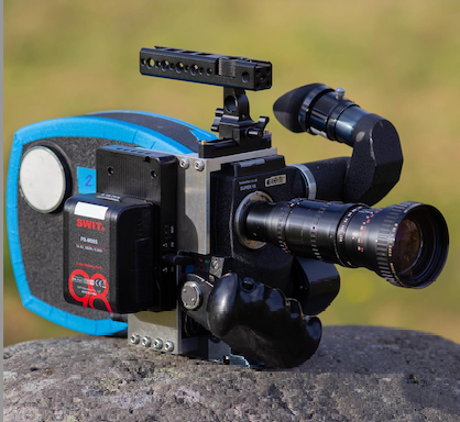

Hi!
I have been looking for a new 16mm battery for my Eclair ACL2, but no luck. My old battery is in the picture attached.
I have tried this type  DC 12V 4800mAh Super Rechargeable Portable Lithium-ion: Amazon.co.uk: Electronics  , doesn't work at all. And this one 12V DC Rechargeable Li-ion Battery Pack for CCTV Camera: Amazon.co.uk: Electronics which works only up to 25fps, the camera stops working at 50 and 75fps. It seems to be a lack of strength.
Any tips to help me finding an appropriate battery? I still have a few BW cans in my fridge!
Thanks for your time!
Luca

It is dishonest by the manufacturer to list these as 12V packs. Their nominal voltage is 11.1VDC.
The Eclair motor needs a bare minimum of 11V to run at accurate speed. Get a 12V NiCd or NiMH pack instead. At least 5Ah. This is assuming your camera is clean and properly maintained. If however your camera is gummed up, it will take a lot more power to advance the film.

No Luca. I'm afraid you misunderstood.
You should avoid Li-Ion batteries altogether for these older cine cameras. Get a NiMH pack instead.
If it was a more modern camera that is built to take higher input voltage, only then would I suggest a 14.8V Li-Ion battery pack.
I would not take a chance to feed 14.8V into a camera with older electronics like the ACL.
You can also use a 12V Sealed Lead Acid battery which is cheaper but quite heavy.

I found Andrew's email. He was replying to questions re my problem getting 75fps. ACLII, latest motor. I'll paste it here, but anyone using these ideas please assume responsibility yourself.
Andrew:
We recommend running the motor with a 4Ah or higher capacity battery and a cable no longer than 1.5m. If the camera battery is weak, then with the motor running at 75fps thebattery is discharged rapidly, with the current about 4-5A (depends on the magazine loads). If the cable is too long or has a small gauge, then at 75fps possibly a few volts can be lost on the cable, causing a loss of motor speed. To run the camera at 75fps you have to use a 12V up to 15.6V Nickel Cadmium or Nickel-Metal Hydride battery at least 4Ah strong ; 15.6V battery works better then 12V at speed 75fps, 30% lower current and less heat. The source of your problem with high speeds might be due to the fact that your battery quickly dropped voltage once the current exceeded 4A, as well as the increased current had been generated by friction in the bearings increased by temperature.
The proper current for the 74fps motor just with the camera body (no magazine) with 12V battery is:
24fps - 0.8A
50fps - 1.8A
75fps - 2.7A
Edited by Gregg MacPherson, 28 December 2015 - 06:32 PM.

Oh, don't worry about that. I'm happy that Andrew was able to confirm that the motor can safely take a higher voltage. Your best bet would a 13.2V pack (11 NiMH cells). At full charge without load, it'll be 15.4V, just under the max of 15.6V.
