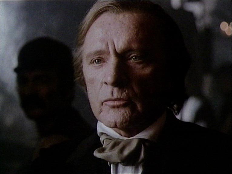

I compared to the two transfers and the new one has its own problems. The original transfer looked like it was from one of Storaro's ENR prints, so very high in contrast but this 2011 one looks like a transfer from an old IP or low-con print and its not any cleaner in terms of dust problems.  The contrast is more natural but some scenes are transferred to light and now looked washed-out.  I had sort of gotten used to the old transfer with huge parts of the frame falling into black all the time.
And the newer DVD is interlaced-scan so even though it is a 16x9 anamorphic, it is actually softer than the old 4x3 PAL DVD, which at least was progressive scan. The whole thing should probably be redone one more time and properly color-corrected and released in blu-ray. Here is an example of the two versions.
You can see that the 4x3 is slightly cropped on the sides and the 16x9 version is slightly cropped on the top and bottom, suggesting that the negative itself was hard-matted to 1.66.  It probably should be shown in 1.66 instead of 1.78 like the newer version.
Here are some examples of the old and new transfer:

Wow, that's beautiful. Do you think the grain in the original transfer comes from the ENR process? The first frame reminds me of Lubezki's work on 'Sleepy Hollow.'

Possibly -- ENR made prints grainier because black silver grain left in the image is sharper-edged than color dye clouds, plus it's an additional layer of grain over the regular grain.  But again, it's silver, not color-coupler dyes, so the texture is different.  This movie was made in 1982 I'm guessing so it's possible that Storaro was using the new "high-speed" Kodak stock 5293, which was 250 ASA.

I think if it were meant to be shown in 1.33 they would have just shot 4-perf 35mm Academy or Full Aperture, but the fact that the 1.77 transfer shows more side information suggests that the negative was hard-matted to 1.66, which was fairly common back then for European features.  Plus the widescreen version is the one that the director says is the correct way to show the movie.
