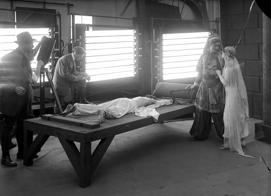

Example of a silent movie set being lit by banks of Cooper Hewitts:
Artificial lighting appeared gradually in silent movies through the late teens into the early 20's as film stocks got faster and lights got stronger.  You can read about it in Barry Salt's book "Film Style and Technology: History and Analysis".  Of course the slowness of the stocks made it difficult to light sets but cinematographers figured it out.  Carbon arc lighting, which was very strong and harsh, was the earliest to be introduced into sets mostly soft-lit from above with daylight coming through muslin sheets, but partially blacked out depending on how dark they wanted the set to go compared to the carbon arc lamp.
Mercury-vapor discharge tubes -- Cooper-Hewitts -- started to be used as well.  Carbon arcs are daylight-balanced and Cooper-Hewitts were blue-green, so both were useful for dealing with orthochromatic film.  Then tungsten lamps started being used, often called "Mazda" lamps (a GE brand name) and panchromatic stock started being used by the mid-1920's.
All the lighting conventions like backlight, fill, kickers, etc. evolved over this time so that by the end of the 1920's, lighting was as complex an art form as it ever has been, even today.
There are also styles that evolve, for example, the soft lower-contrast diffused look of the late 20's through early 30's that was replaced by the higher-contrast, harder-lit style of the 40's.  That was mostly due to a change in taste about images, you see it in still photography as well.
That´s a great picture, thank you! :)
From when is this?
I see a lot of those lights, but they are standing like a wall. Didn´t they also have spotlights, or just this type of light?
With "slowness" you mean that the stock needs a longer exposure time?
Oh, so the muslin sheets worked as a diffuser? I guess, they also used diffusers in the 20s to create a soft light like in my picture? That there was a lamp directed on the face(s) and a diffuser in front of the lamp to create the soft light?
Thank you very much :)

#6 David Mullen ASC
  • 20318 posts
Posted 05 June 2017 - 10:34 AM
Strong backlight provides separation from the background but it is also "pretty", romantic, hence why it was popular back then.  Not everything is done for an intellectual reason, sometimes it's done to beautify the scene or actor, hopefully supported by the story.
They used carbon arcs for spotlighting back then.

#11 David Mullen ASC
  • 20318 posts
Posted 05 June 2017 - 07:20 PM
There are many degrees of softness, so just because there is a nose shadow doesn't mean the light is hard, it's just not super soft.
For soft lighting back then they probably would have used the Cooper Hewitts but there was also softening by putting something in front of a hard light, like muslin or spun glass in frames -- it's just that they were limited by the fact that muslin could catch on fire if the light in front was too bright or too close (hence the use of spun glass over time.)  So generally diffusing lights was done on a smaller scale with smaller lights closer to the actors, not like today where you shine big lights through giant frames of diffusion (and you wouldn't have made a giant frame of spun glass back then).
You should get this book and flip through all the photos of soundstage shooting:
https://www.amazon.c...s/dp/0811844161
You often see lights with small frames of diffusers in front (usually spun glass), like in this attached photo.
The other thing to keep in mind that for wider shots, the lighting often looked softer because so many multiple hard lights were used to spread light across the set, and with one light spilling over the light next to it, you get a semi-diffused effect.

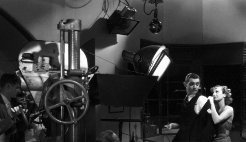

Here is another example of "broads" and "scoops" with frames of diffusion in front of them.
I guess it was taken in the 30s or 40s. You can clearly see that filter in front of the spotlight.
The most important thing for me was the question, if they had (and used) soft light in the 20s.
